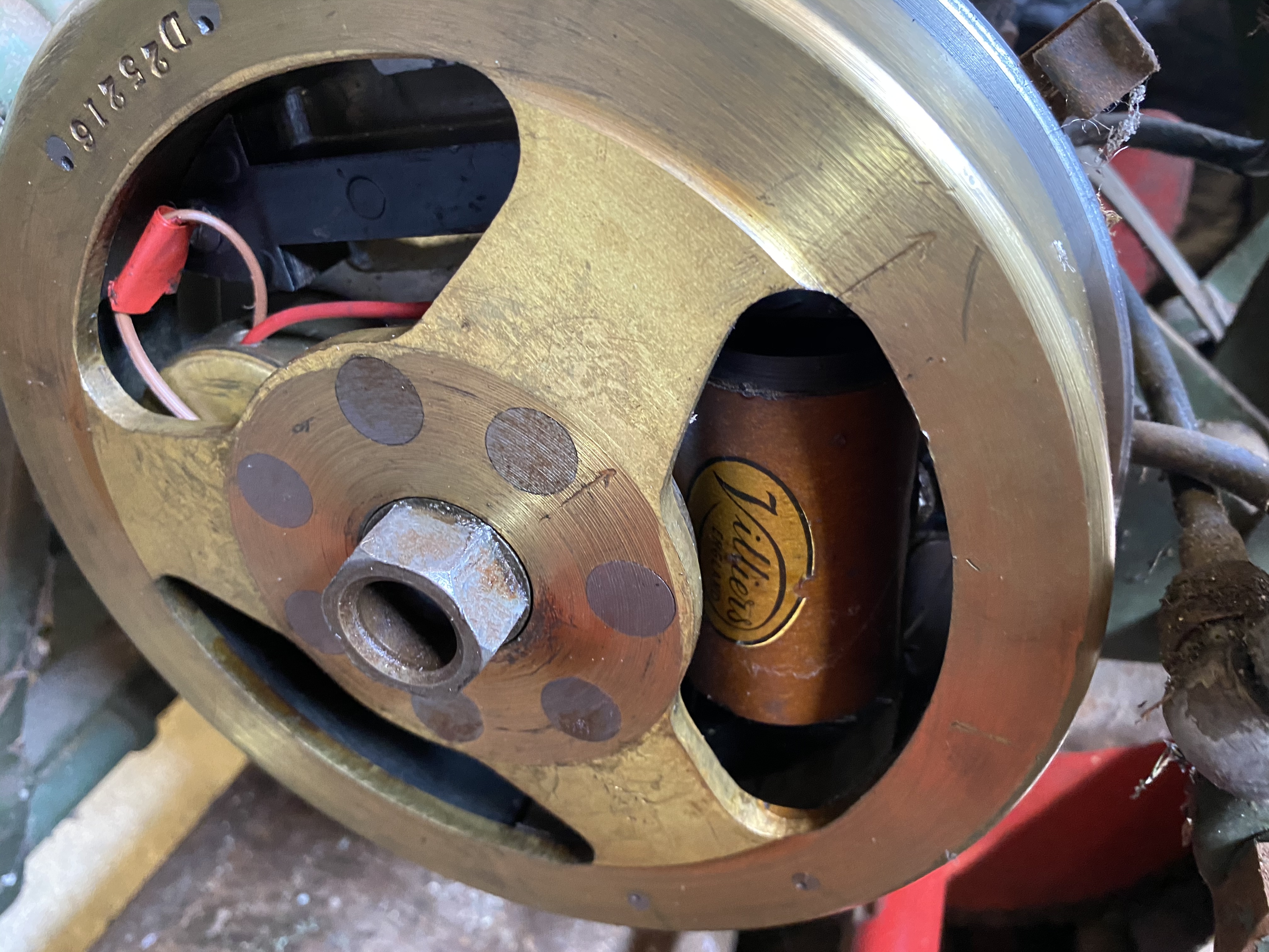

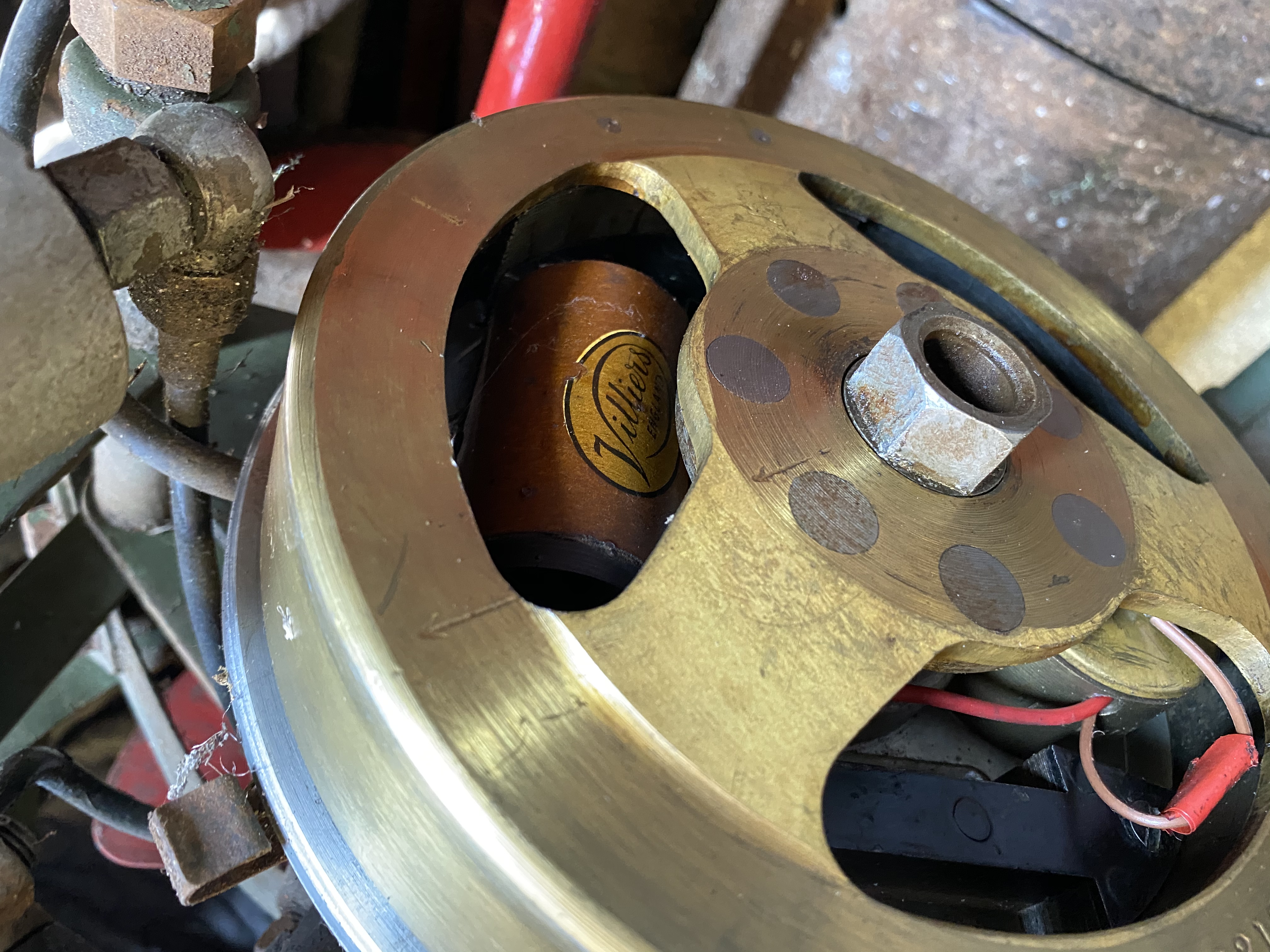

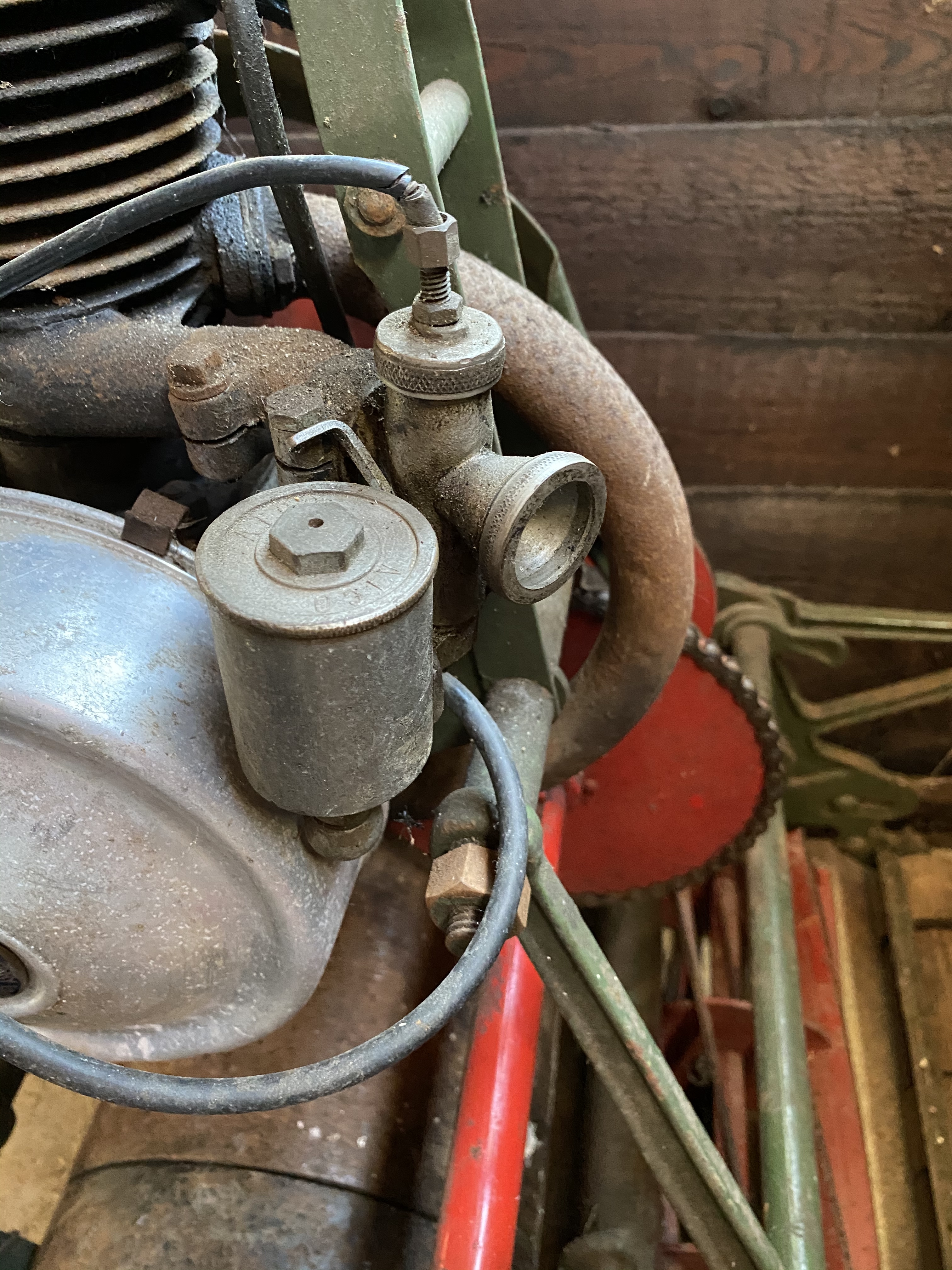

finally got round to taking the carb off - not sure if it is the original one. Is it missing an air filter of some sorts? Hope I don't have to replace the whole carb for the sake of it as the rest of it is beautifully made.
going to give it a good clean and see if she will go - not much sign of a spark so I suspect my next stop will be the contact breaker points - can I get at those without taking the flywheel off?
many thanks
nick

Hello, just as a matter of
Hello, just as a matter of interest where does the pink wire, covered in red tape go to? And you can slide the points cover catch over to remove the cover if you turn the engine over to allow access through the flywheel. I am currently working on a 16" Standard also with no spark but unfortunately it appears to have some some bottom end bearing damage so I am locating some engine parts to complete the project.

Pindernick: the carb is original and complete except for a circular metal gauze inside the air intake - this is held in place by the circular metal ring that unscrews and appears still to be in place.

Looks like you have non
Looks like you have non original colour coded wiring. One wire from the coil to the points and one from the points to the condenser which is buried under the points box.  There may also be a wire from the coil or the common terminal on the points to a springy kill switch on the back of the stator plate .
Yes, you can usually manoeuvre the points cover off without removing the flywheel but you will usually end up removing it anyway !
