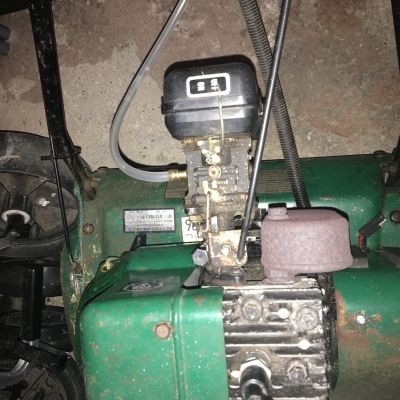

Trying to get a set of gaskets for stripping down the carb on, what I suspect is, an early 90s Qualcast 35sk. I've tried the place in Gateshead with no success. Any other ideas?

The make of the carburettor
The make of the carburettor and an image will help.

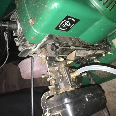

It's one of these.I'm not
It's one of these.I'm not certain of the name. Any help would be greatly appreciated.

Struggling a bit but of the
Struggling a bit but of the three possibles, Dellorto, , Walbro/Tecumseh and Tillotson, I can only eliminate the Dellorto.
Going to do a bit more research but meanwhile please give the carb a close examination for any numbers or even a name cast or stamped into it
EDIT
On second thoughts and looking at the shape of the choke lever, I think that it may be a Tillotson.
The bowl gasket would be  Atco Qualcast part number F016Q10076 ( Tillotson No. 16-B388X ) and if you cant find one through the usual channels, try Jon Cruse at the Hailsham Mower Centre 01323 842477 or Hugo at Rowena Motors 01248 715552.

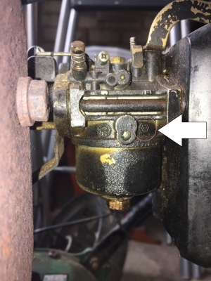

I think you may be right. The
I think you may be right. The only marking I can find is this...
Which does look remarkably like the Tillotson logo

Does look fairly approximate
Does look fairly approximate !  I’ve neither a Tillotson carb nor a good enough image to do a detailed comparison but I think that we may be on the right track.

Got the appropriate gaskets
Got the appropriate gaskets from JAPG-mowers and stripped down and cleaned the carb. Was exactly the one in the PDF you sent. Thanks.
For anyone else doing this, a small pop rivet is the perfect calibre for tapping out the float fulcrum pin.
