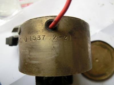

The OLC profile says that my HY was made between 1929 and and 1933 "or there abouts" . Quite happy with that until I unpacked my parcel of mag parts from George at Villiers Parts this morning and started the mag rebuild. There on the side of the round points and condenser housing is what appears to be a date - 1937. A bit far out for "1933 or there abouts" - or is it a part number?
Keith Wootton Fri, 24/05/2013
Actually, the more important number here is the 21 at the end as that, I believe, signifies the date of the patent.
The date range for the HY model on our profiles is reasonably accurate as far as I know (I wrote it by the way). By the middle 30s Atco had left the Atco Standard and HY designs far behind and were producing models that looked more like the range they continued with until the late 50s.
wristpin Fri, 24/05/2013
Thanks - no slight intended! So does that mean that the patent on the contact breaker box was 1921?
