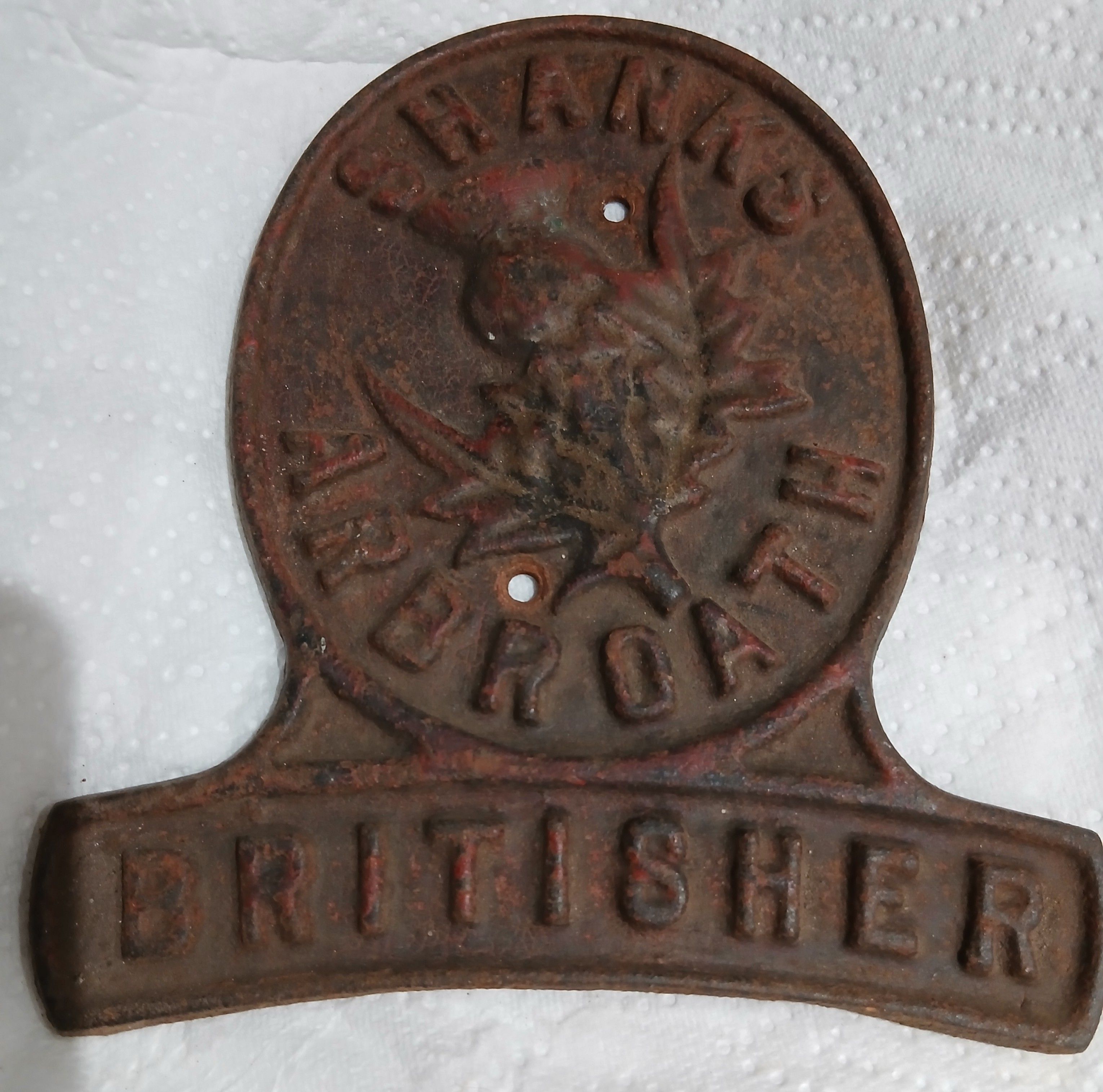

Hi folks,
I have recently bought myself my first old lawnmower badge and need advise on how best to remove rust from the badge whilst leaving the remnants of the original Red paint intact, OR,should I just leave it as it is. My usual 'go to' White Vinegar I think is going to be too harsh ?
As always, thanks for any advice.
Rob

Hi Rob, I would use nylon brush with soapy water dry thoroughly with heat gun, hair dryer or in rhe sun!, then either paint with Owatrol or apply wax based polish.

Hello Rob,
  1.  Just leave as it is and put some freeing / maintenance fluid on it (i.e. stuff in Blue & Yellow tins /  containers)
2. Clean off to bare metal and repaint with primer and top coat, then the decision of what colour to use.
So the decision is yours.
