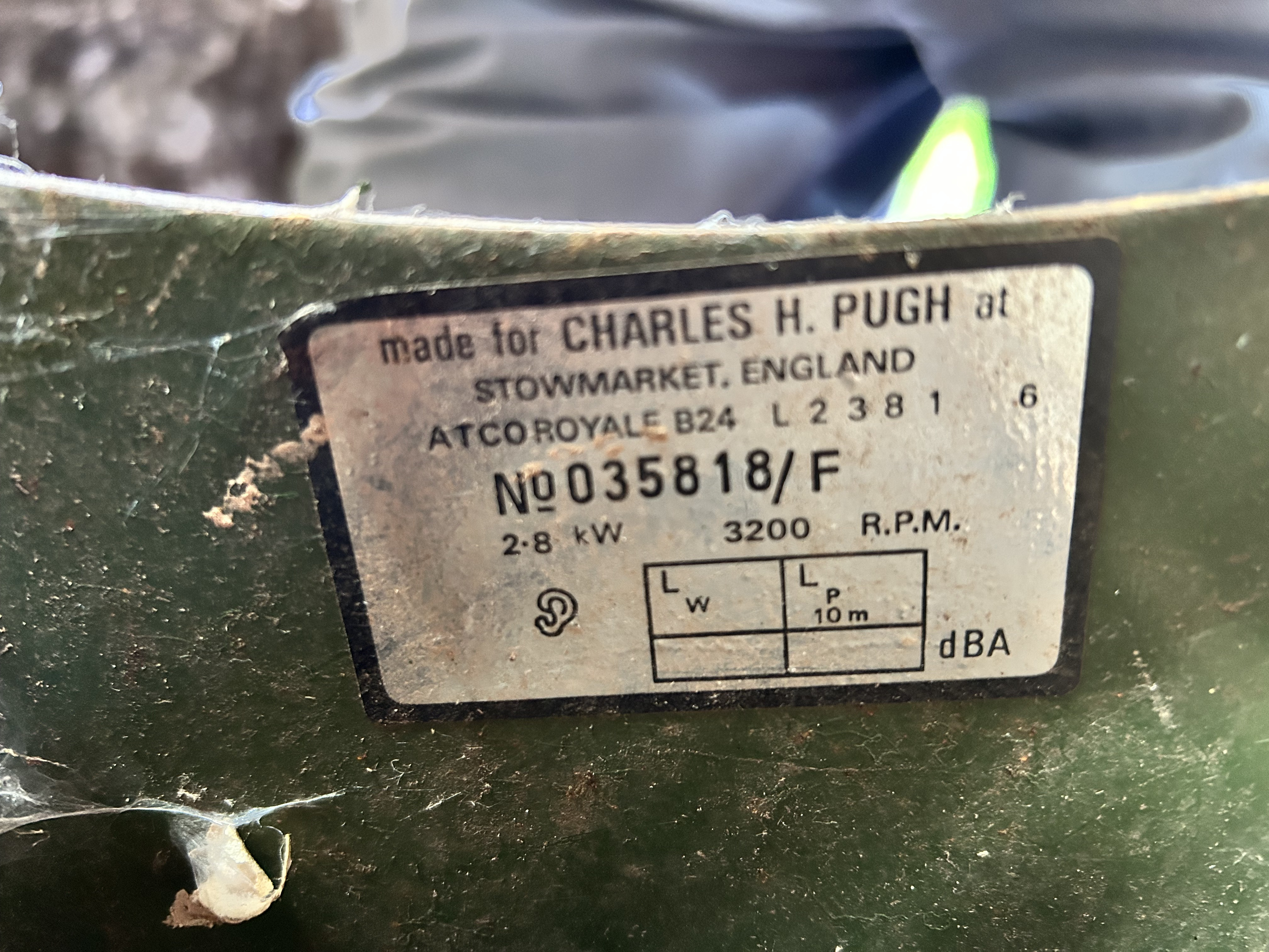

I am starting a restoration of an Atco Royale B24 with a Tecumseh engine and a metal grass box.
I can't find an engine code or a year of manufacture so I'm not sure what i'm dealing with.

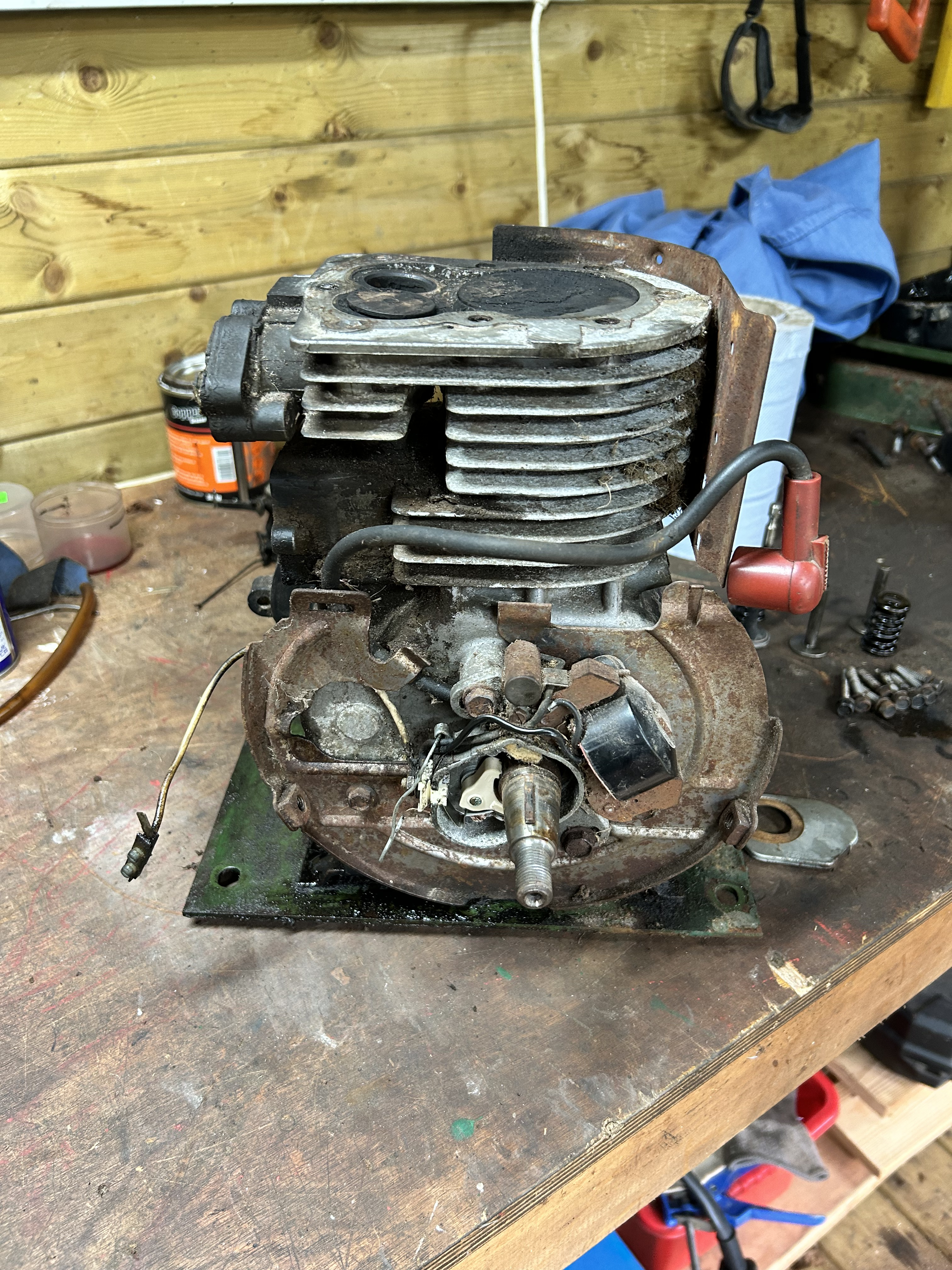

Hi Henno, thanks for your reply.
I have identified the engine as a H50, but not sure what year.
I have stripped the engine,
checked the piston, ok
reground the valves.
changed the plug, points, condenser and coil.
Carb and fuel tank cleaned
I now have compression, fuel and a spark.
However, I can't get a peep out of the engine. I have tried a squirt of brake cleaner in the carb, still nothing.
I set the points and timing by eye so now i need to gat a DTI gauge to be more accurate.
New carb is on the way.

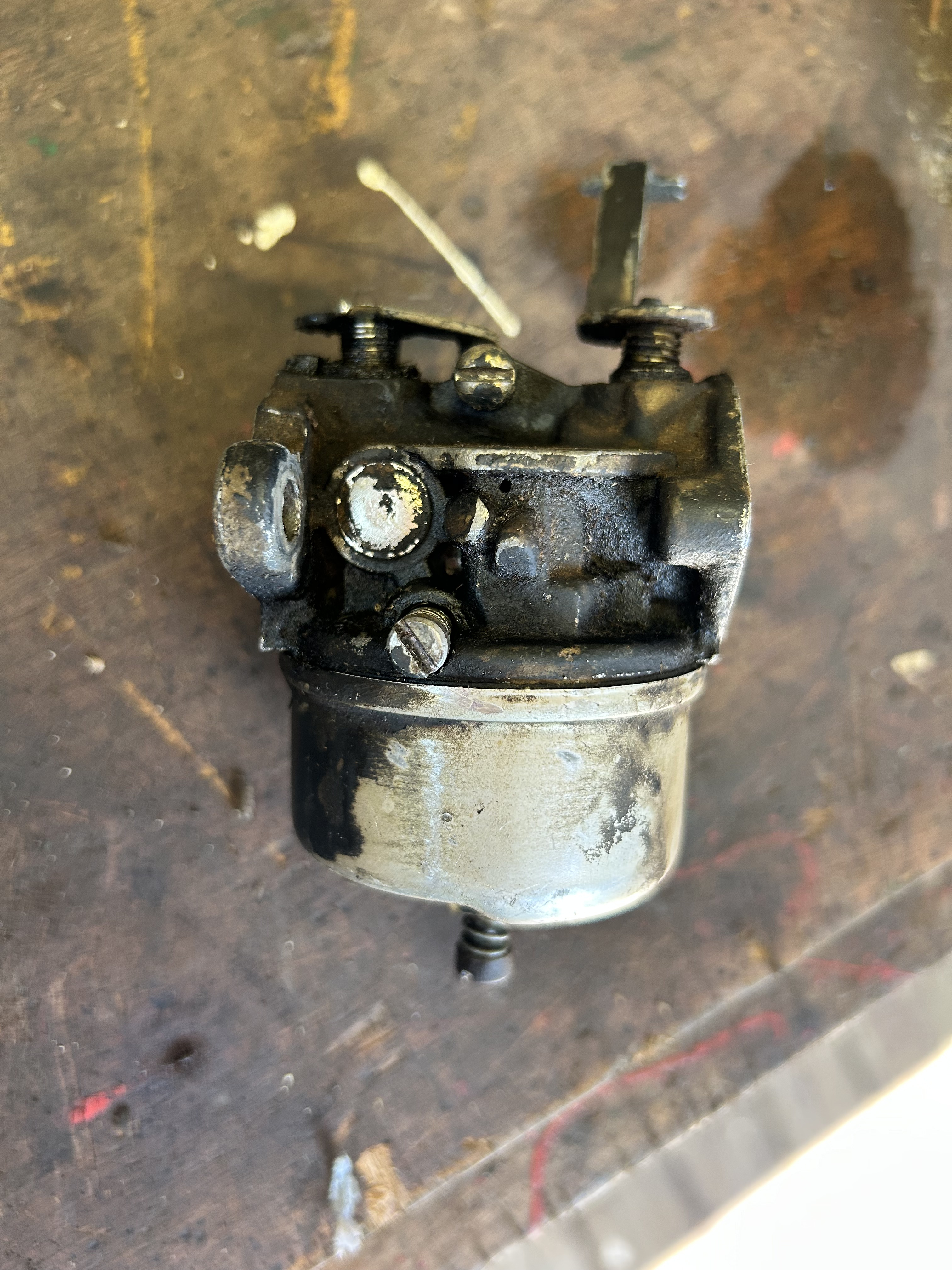

carb
Henno Tue, 12/08/2025
The carburettor looks just a bit dirty. It should be possible to revive that?
Just some carb cleaner spray, some parts like and O ring, maybe a bath in the ultrasonic tank.
What brand model & type is it? Also a Tecumseh?
