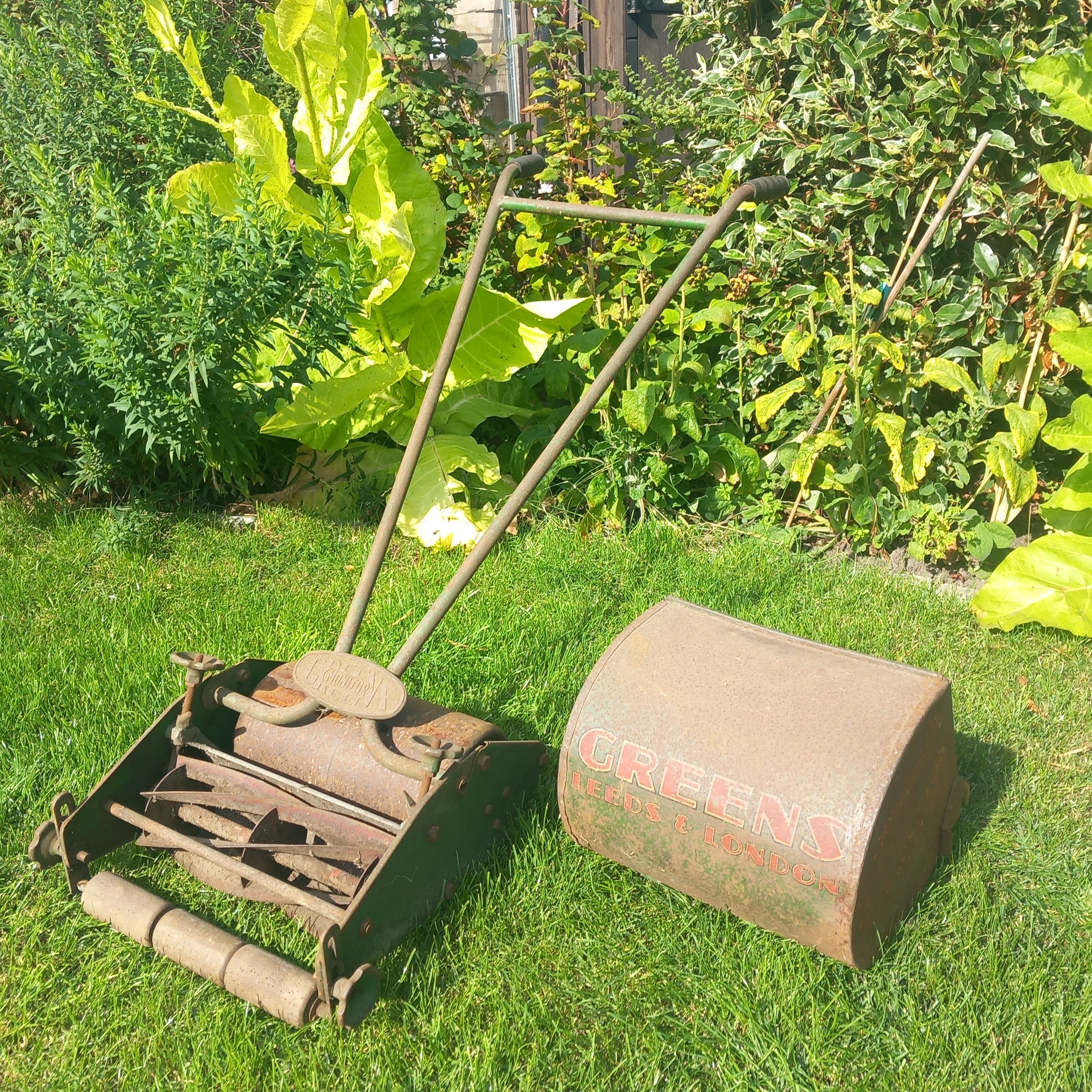

I've very recently taken possession of a rusty Greens Monitor. I'm hoping to tidy it up to the best of my ability and means. I've started to strip it down but need advice on certain things if I can please.

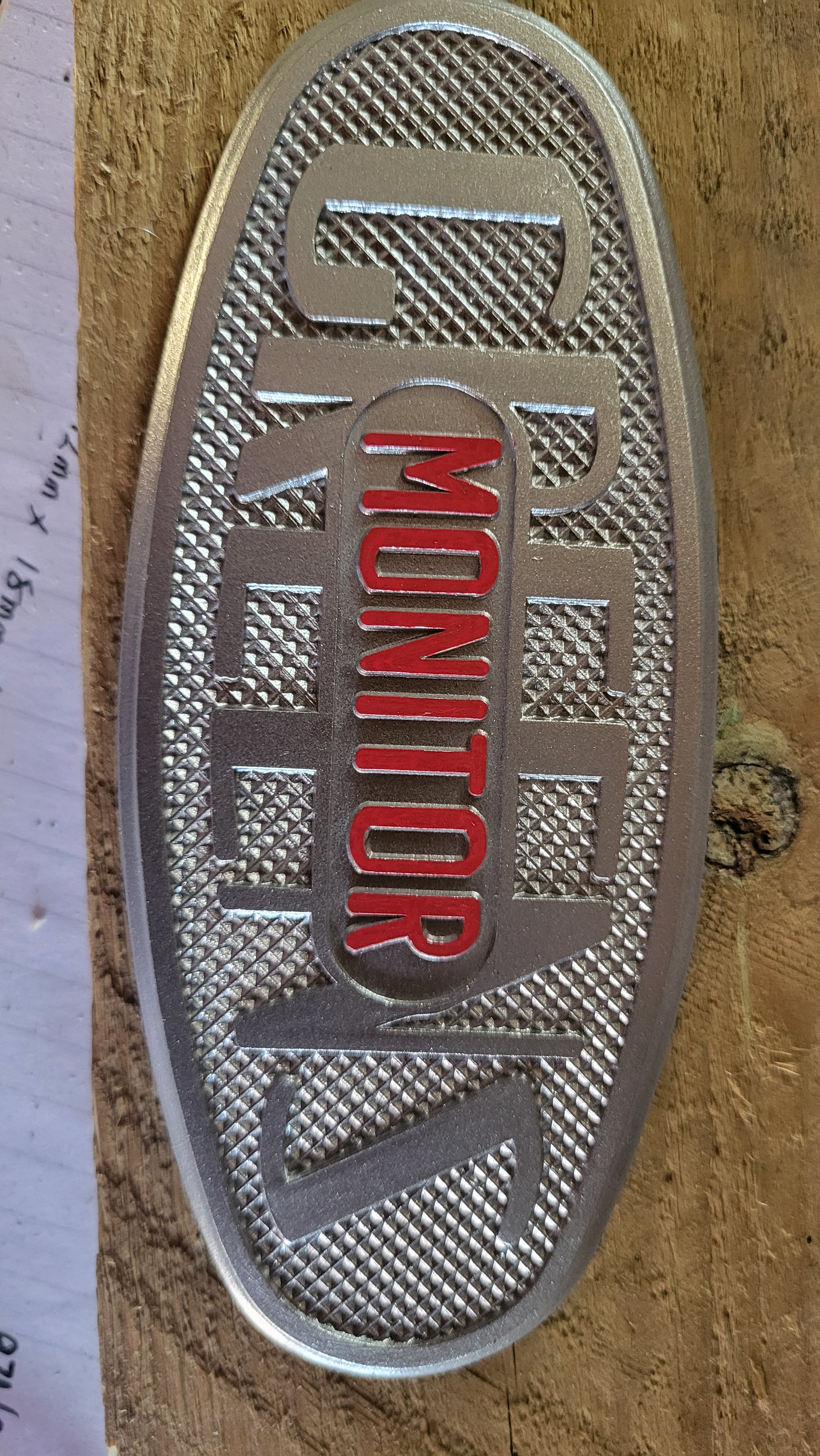

- My first job is the name badge. Does anyone have any pics of the correct colour of the badge please.

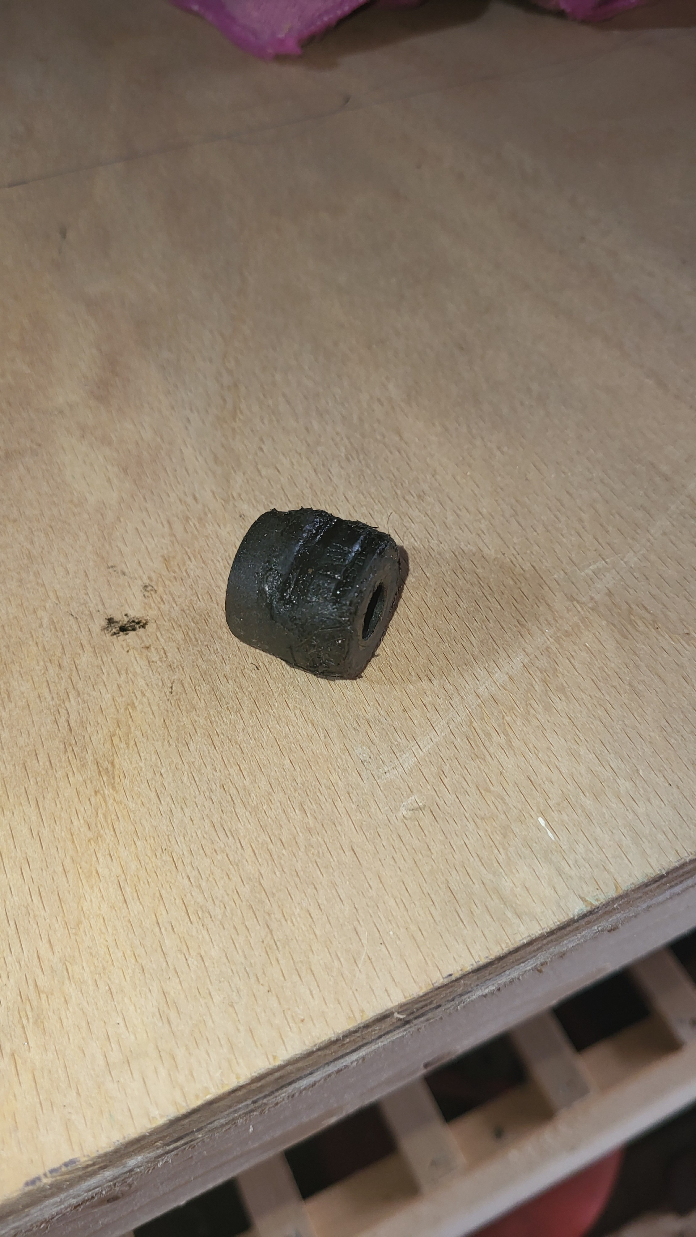

Finally (for now 😊) where can I get a grassbox and a rubber chain tensioner as mine must have stopped turning at some point so has a massive flats spot. Thank you Oh! One more thing; where would I find the model number please? Is that it on the back of the cast aluminium back plate?

My Monitor (as per posts a few weeks ago) has the same cast iron badge as your one.
With painting you are free to do what you like, as you own it, as per previously mentioned and on other Forum Posts on the said Mower, it seems there were several different badges on the Green's Monitor. The badge on My Monitor appears to have been green, with red lettering.

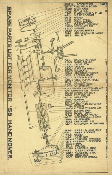

Now, I'm sure I found a Monitor parts diagram.....

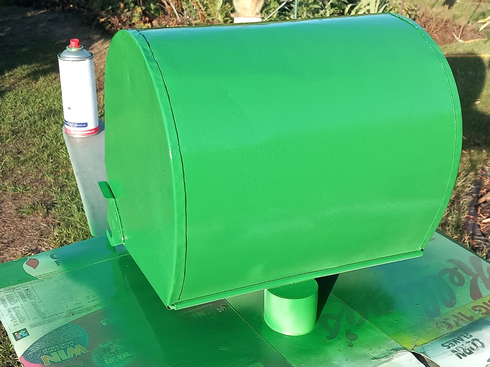

In between dismantling and wire brushing etc I've been sourcing paint ready for when I spray and/or paint but I've run across a issue with paint colour's and shades.
Using the RAL chart I have got RAL 6002 in a spray and also bought a RAL 6002 paint pen but they are completely different in shades.
How can 2 shades of green be so different when both say RAL 6002 on the can/pen? Has anyone else had this issue before?

Funny you should mention RAL6001, I have just used this to spray my Monitor box after shot blasting and phosphoric acid treatment and etch priming. The colour you wish depends on whether be as the faded colour the mower is now after 60 plus years or the colour under the chain guard, which you will note very contrasting or bits of metal where oil and grease has corrupted, i.e. inside the chain-case.
From previous Forum Posts there was at least three styles of Monitor badge, see other posts on the Forum.....Which is your one like?
As I say, I just got a Monitor myself, the Grass-box is the first thing I have restored / conserved, as its the most fragile and costly / time consuming bit to replace. They rust where the steel spot welds / joins meet. And naturally get based by running into objects!
Unless a member has one, finding one is like Rocking Horse Flowers, see also Clive's info on Monitors on different box designs. A skilled Metalworker can make a box, but costly.
Please send photos of the chain and sprocket condition. Quite a few Green's Monitor 's seem to be coming out the woodwork currently, how far you go depends on your spend criteria.
I bought my Monitor to use, knowing from previous experience of mower-money -pits, what to expect. As I say, please post some photos...
