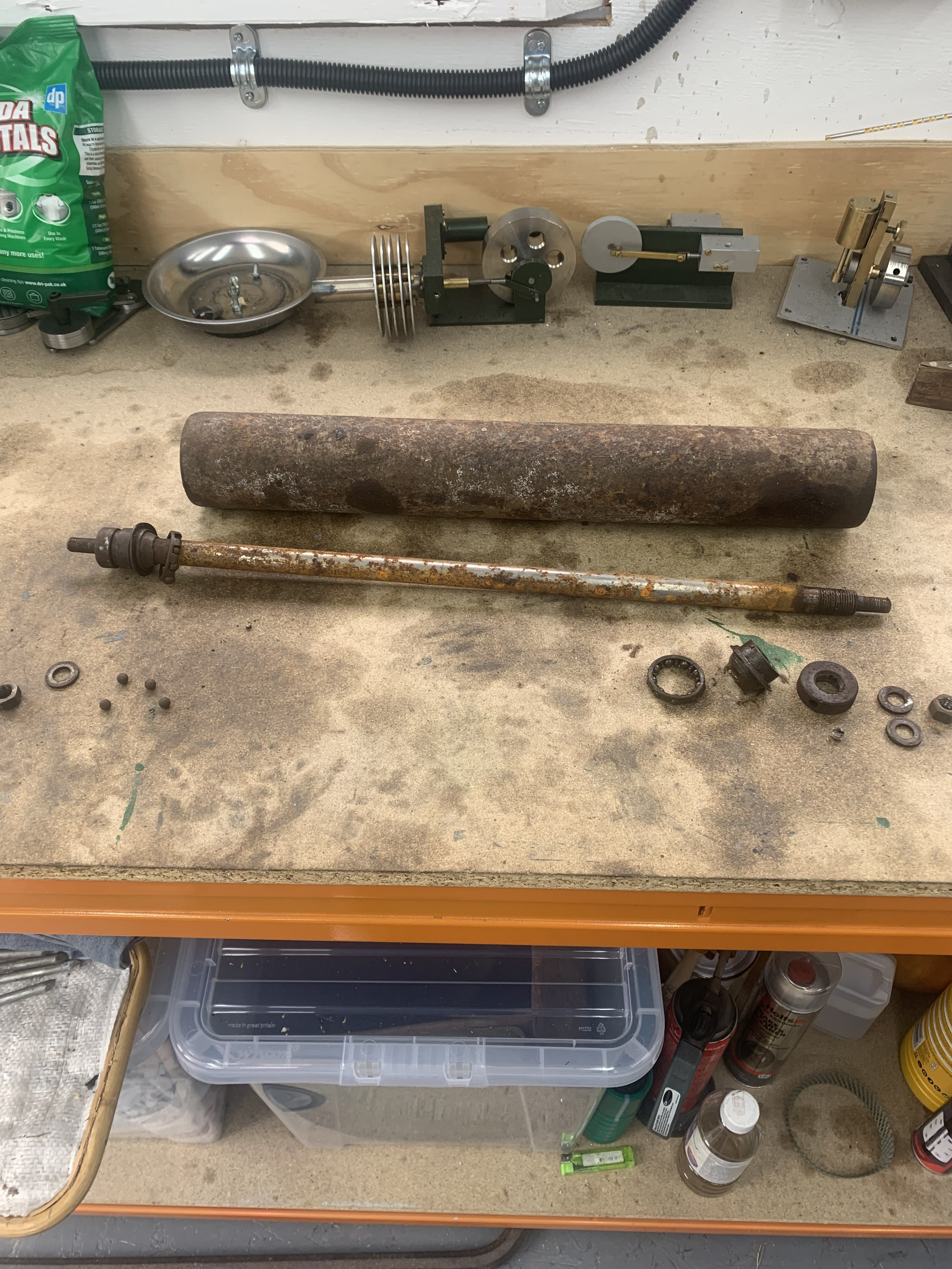

First stage - rusty roller

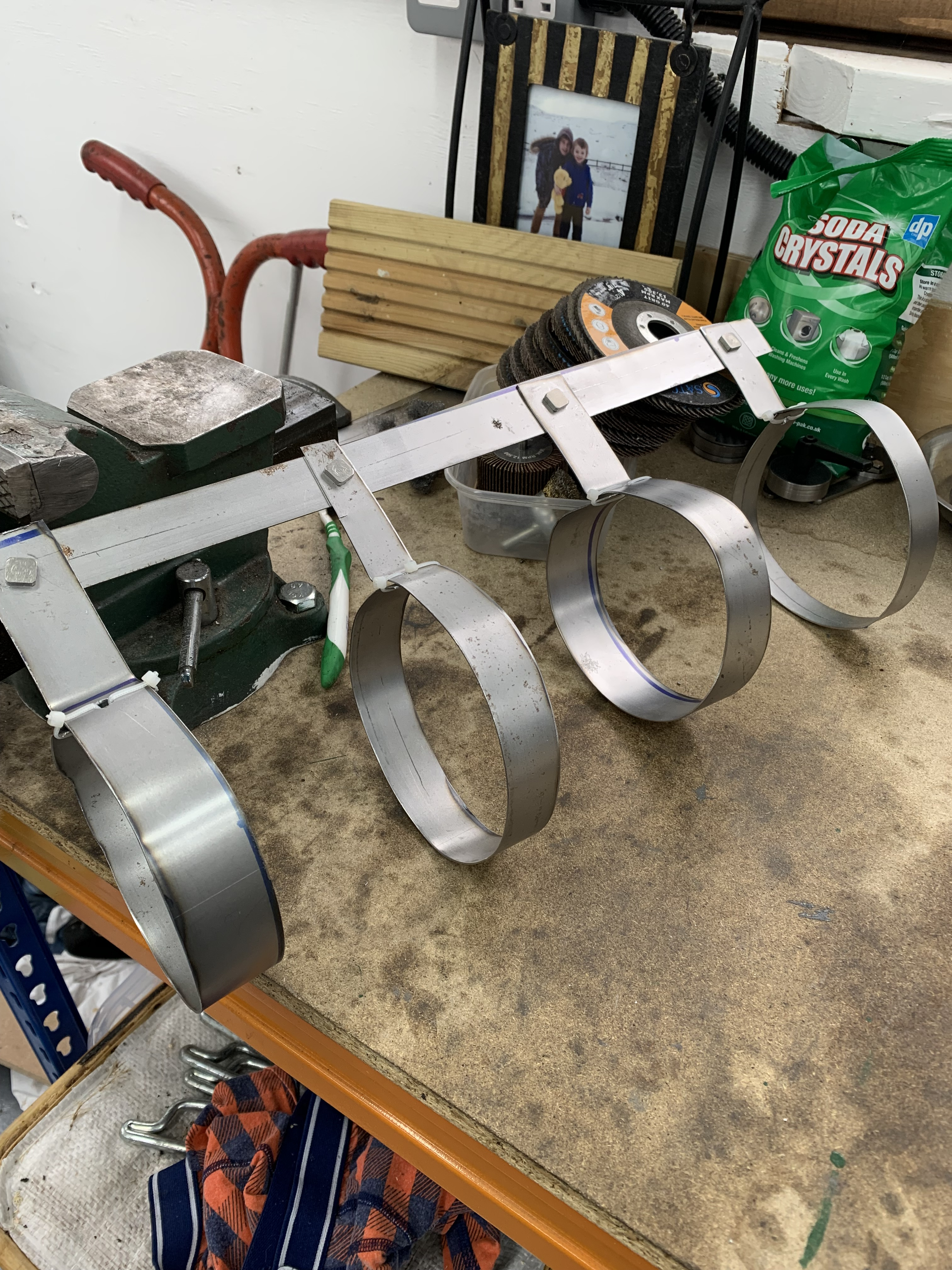

Then made an anode to go round the roller in the electrolysis bath from some strips of mild steel:

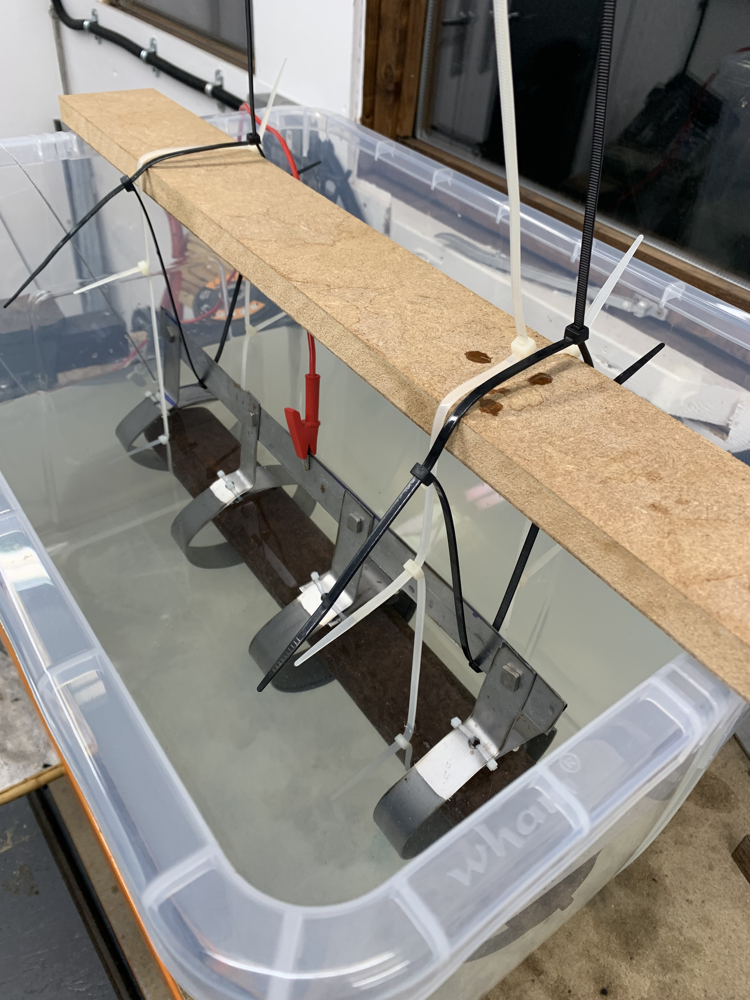

All hooked up in the tank:

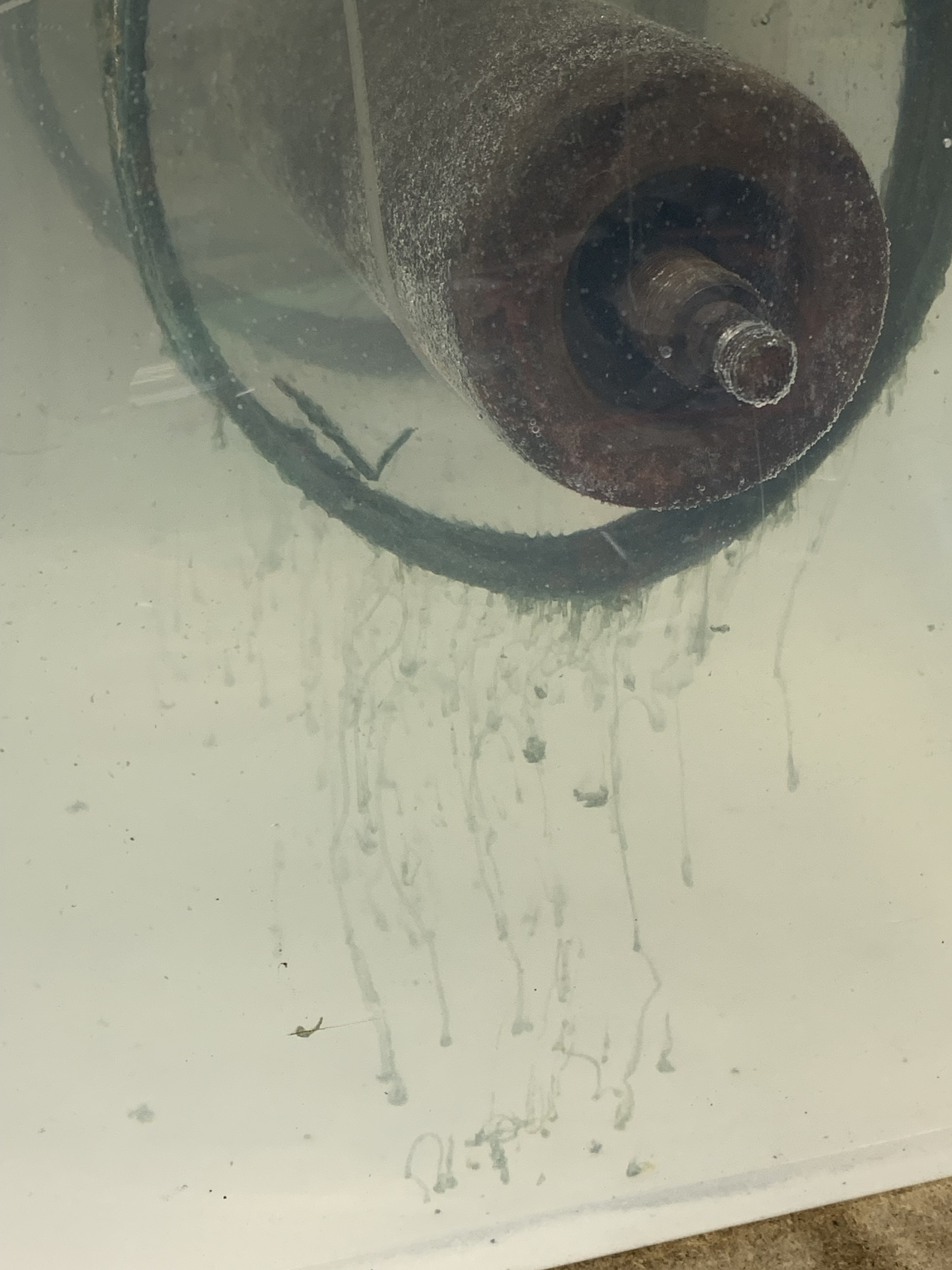

Electrolysis underway:

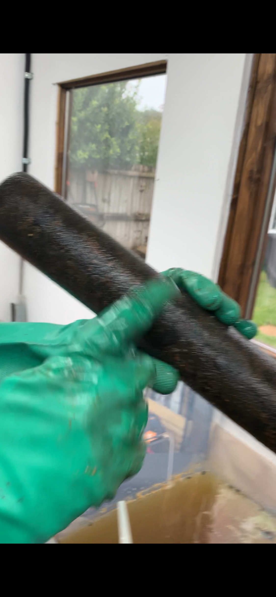

Post electrolysis with a layer of black carbonate residue:

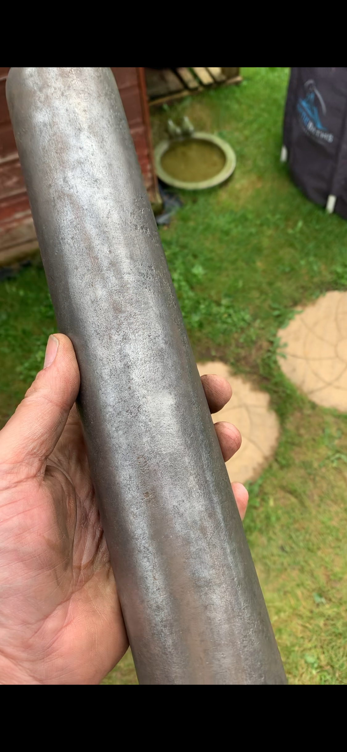

and after a scrub, ended up like this:
So I'm rather pleased, but needs the acid dip and then electroplating - I'll post some pics when I'm at this stage.
