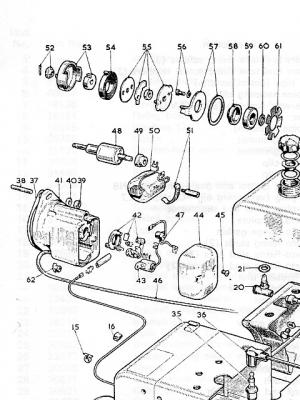

Does anybody has an exploded vieuw of a Wipac CJ for my JAP engine ?

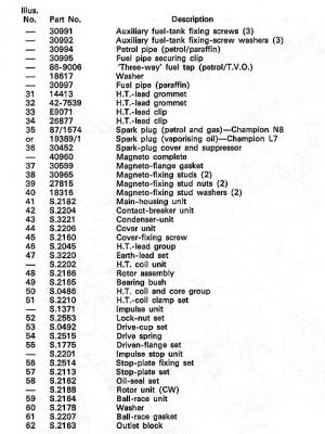

The exploded vieuw is  from a C45 list of parts, part nrs. starting with S... are Wipac part nrs. as far as I now.

Does anybody knows how to put item 57, the stop for the impulse mechanism.
