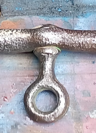

I wonder if anybody has definitive evidence of how the rope was connected to The Green's "Silens Messor" drawbar?
Was it simply knotted through the hole, or was a metal hook tied to the rope then that hooked through the drawbar eyelet for easy removal?
I'm sure some close up old contemporary photograph must exist?
Then there is the question; dd the rope go through the wooden pull handle?

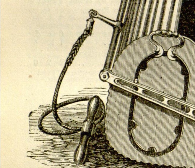

Illustration from 1865 advertisement.....

I think you should copy the one in the 1865 advert, how are your rope weaving skills?

The best answer is probably found in the Parts list. This shows the ' Drawing Rope ' going through the wooden handle and having some sort of small snap shackle the other end to attach to the drawbar. This is the best extract I can get :
