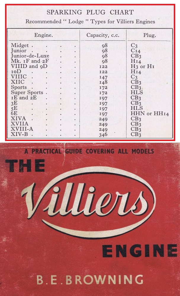

Good Evening,
Please see extract from  the definitive work on Villiers 2 strokes by Browning:-
VI-C   147cc  not listed, but was replaced by the VIII-C    147cc  which  the book says is Lodge C3
