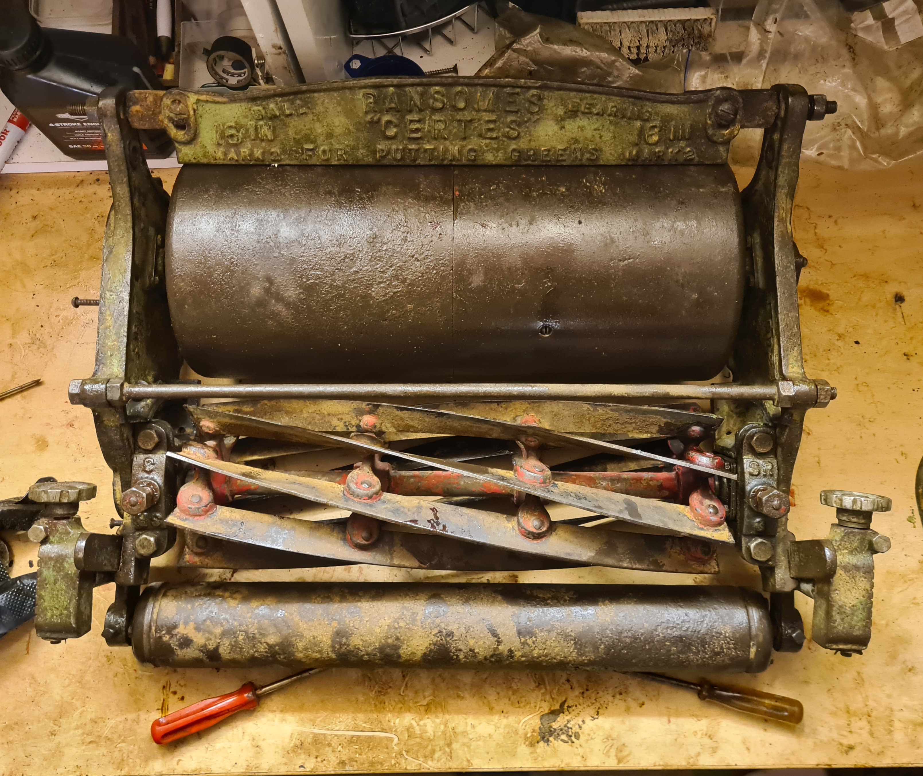

I have come across two issues if anyone can help. The first is quite simple the bottom blade is connected by 4 screws. I have put WD40 on and left for a while, but do not seem like they want to budge. Taking your advice of not forcing I have put some more WD40 on and left it. See photo, any suggestions.
The second is trying to remove the cutting cylinder. I have removed both clamps and springs and both sides can move up and down, I can completely lift up the side opposite the gears, but the problem is the side near the gears has a rod coming through which prevents me lifting it any further. The video I watched showed this being removed and all he did was wiggle it a bit and it came out. It does not want to come out for me. See Photos and any suggestions. Thanks in advance.

You need a good impact driver to mover those screws. Soak in oil WD40 isnt that great .

Thanks Chirpy, I used some better oil and got my friend to help with the impact screwdriver and now have it all in pieces. It is in much better condition than I thought with all the bearings, and gears in good working order and the bottom blade is in great nick. The tips on the forum and the web site  were very useful, especially the don't force it, take your time. I will now learn about stage 2.
